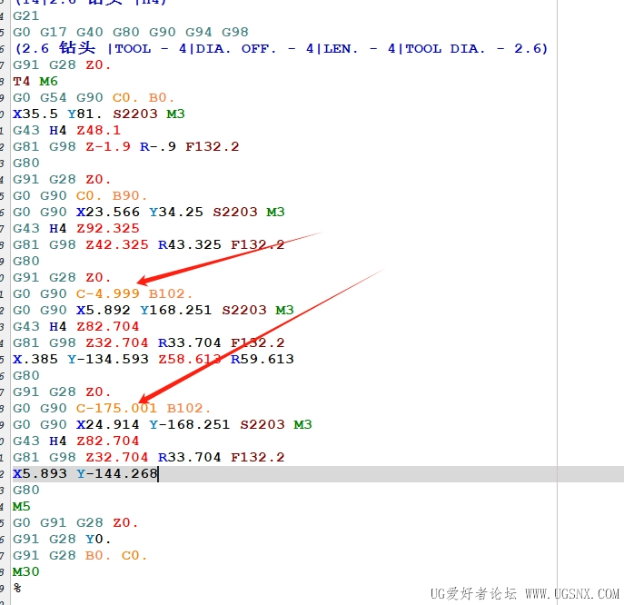

发表于 2025-4-5 21:27:29 | 显示全部楼层 |阅读模式

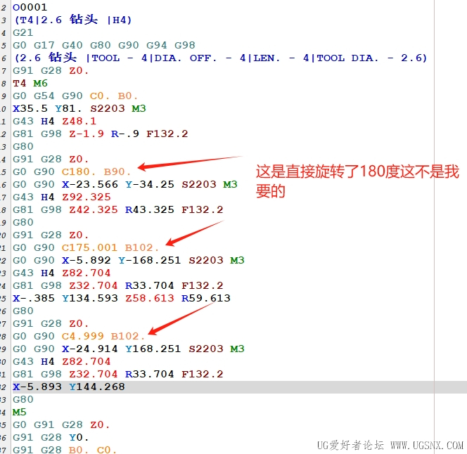

发表于 2025-4-6 11:29:21 | 显示全部楼层
#Secondary axis angle description (in machine base terms)
#With nutating (mtype 3-5) the nutating axis and this plane normal
#are aligned to calculate the secondary angle
rotaxis2$ = vecz  #Zero
rotdir2$  = vecx  #Direction
将rotdir2$  = vecx  #Direction
改为rotdir2$  = -vecx  #Direction

 楼主| 发表于 2025-4-7 01:25:31 | 显示全部楼层
#With nutating (mtype 3-5) the nutating ax ...
应该是我表达错误按你说的改的直接是旋转了180度E:\图片

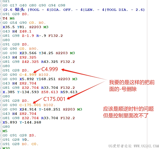

 楼主| 发表于 2025-4-7 01:28:22 | 显示全部楼层
我要的是把-号删除数据变
