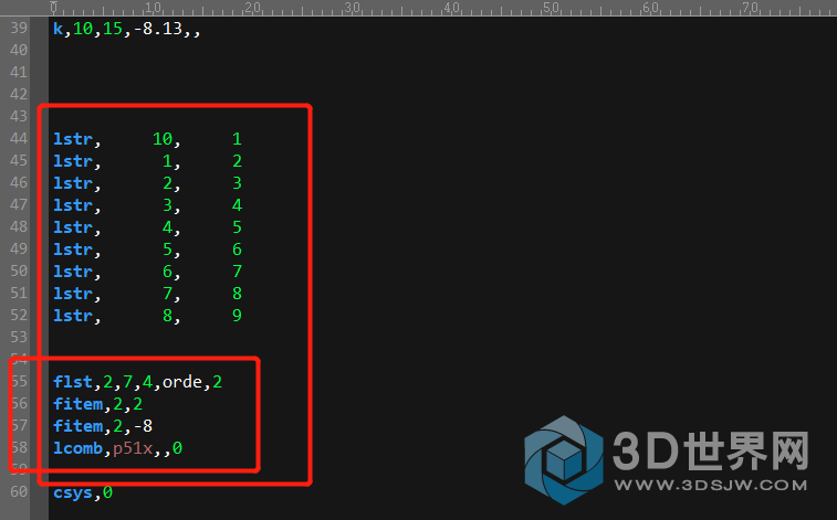

问题一:
ansys命令流中有wprot和wprota这两个命令,他们两个命令的区别是说明啊?
问题二:
下面图片中命令的含义是什么?请求详解

发表于 2019-9-29 16:28:27 | 只看该作者
WPROTA, THXY, THYZ, THZX
Rotates the working plane.
THXY
First rotation about the working plane Z axis (positive X toward Y).
THYZ
Second rotation about working plane X axis (positive Y toward Z).
THZX
Third rotation about working plane Y axis (positive Z toward X).

 楼主| 发表于 2019-9-30 09:03:14 | 只看该作者
wprota和wprot是同一个命令,系统升级后wprot命令后面增加了一个a
